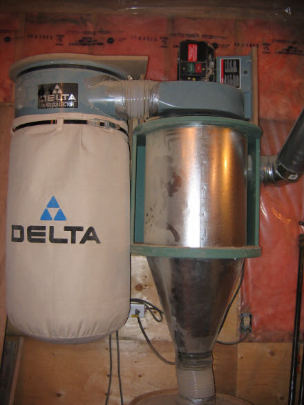

I think the numbers quoted on the e-bay site are drop-out numbers in the cyclone. I built a cyclone from a plan I got in Wood Magazine a few years ago. I adapted it for a 1.5 hp delta dust collector and works OK. It is certainly not big enough to run my 20" planer on all day. But I do fill the 45 gallon drum regularily with it and it works well on my re-saw. But a cyclone won't filter out the small stuff, that usually goes into the filter system, in my case a 5 micron bag. I should really get a finer bag but haven't yet. Anyway's, I will take a picture and show everyone how I adapted a $300 dust collector into a cyclone. Having built one, $139 dollars for that cyclone is a good deal, in my most humble opinion. It is how you set it up that will determine it's effieciency. I would recommend larger than the 1hp he talks about. I think 1.5hp is too small. But as Rod said, there is great satisfaction in building these things yourself and it gives you a better understanding of the system and the process.

PostPosted: Wed Aug 31, 2005 6:20 pm
As promised!
The plan from WOOD mag, and the one you sent to me Rod, is missing a baffle on the inside. So if anyone is going build from this plan I will explain further. Also I am available if you have any questions or hick ups and I can explain how I got my system from a floor model on a platform to this cyclone. It was fun to build and does work fairly well.

The picture of the one I posted above is a 1.5 hp. For a one man shop and set up centrally so your runs are small it works quite well. But it is what it is, a step up from a non-cyclone but not an industrial set-up. If you can get that PDF file from Rod. It has a bunch of technical info about cyclones in it as well.

I moved onto my property 3 years ago. In that time I my youngest son got sick that resulted in a liver transplant, which I donated. So that put me out of commission for 8-10 months, no lifting allowed for most 2004. So I am set up in a friends shop that I built for him in 2003. It is far from ideal and I am not that interested in experimenting until my shop is completed at home, hopefully next year. The dust build up usually occurs when I am re-sawing wet spruce. There is a LOT of saw dust that has a small surface area and is heavy. The re-saw is some distance from the collector about 25 feet and the duct has to turn a full 180 degrees before it reaches the saw. But I know that with better planning this collector would work just fine. My largest runs are all 6 inches. If I was to build again I would a 2 or 3 hp collector and add this cyclone. You should know that it took quite a few hours to build, but was fun. When my shop is built I will either buy a new cyclone and use this one just for the re-saw or I will build another, probably 3 hp. Like I said, they work well but more hp will certainly be better! Don't forget that extra interior baffle, it makes all the difference to the performance of these things, I added it later but did it while I was moving from one shop to the next so I had the unit torn apart anyway.

Very helpful Shane. Can you discribe the extra baffle that you added?

I don't think we can be embarrased by the tools that keep us going until we can afford either the time or the money or both to get something more along the lines of true needs! I am just happy to able to help out with some of this tool stuff. The baffle is insdie the cyclone. As you look at the front of the pictures I posted earlier you can see that the inlet pipe enteres the cyclone on the right hand side and too the rear of the upper cylinder. Inside that upper cylinder is a six inch pipe that is the same length as the upper cyclinder and is in the middle of the unit, right below the impeller. The baffle is placed against the outside wall of the upper cylinder and extends from the top of the unit down to about 2 inches below the inlet. And it extends from the outside wall to within about 1 inch of the centre pipe. Am I explaining this clear enough? I had to open up my system when I was in the shop tonight just to see what I had done. If this isn't clear I will try to draw it, scan it and post it.
